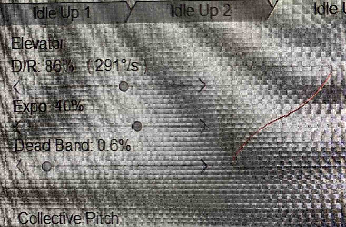

My friend has his dual rates in the Flight Mode Configurator also displays the degrees per second for elevator, The status bar shows some variation of this. My FMC only shows the Dual Rates in %. I’ve hunted around the menus and can’t find how to turn it on.

I’m trying post a pic of his screen. It’s under 200KB however it’s too big.
I should add that my friends screen also shows deg/sec for aileron and rudder, (helis).
For example, his setting of DR 86% ele and ail also is shown as DR 86% DEG/SEC 291.
A little calculation shows 291/.86 = approximately 338 deg/sec. Then each 1% increment is about 3.38 deg/sec. I love this as I can set my numbers the same as RotorFlight rates on my helis.
For those interested, yaw comes out 630 deg/sec at 100%.
Rudder: 89% is 561 deg/sec. 561/.89 = 630

Re: Dual rates
here is a pic
- Attachments
- pic of degrees/second
